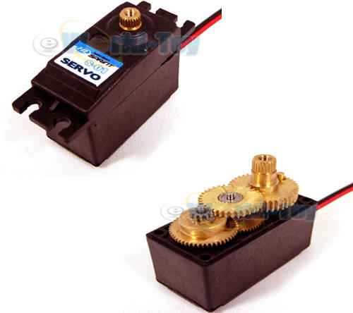

This is the Same servo i use
and now have 3 of them Completely Waterproof now .
and thay are SWEET!!!!!!!!!!
Dimensions: 1.57" x 0.79" x 1.44" (40 x 20 x 36.5mm)
Weight: 1.78oz (48g)
Operating Speed (4.8V no load) : 0.17sec / 60 degrees
Operating Speed (6.0V no load) : 0.13sec / 60 degrees
Stall Torque (4.8V): (13kg/cm) (180oz/in.)
Stall Torque (6.0V): (15kg/cm) (208oz/in.)
Temperature Range: -30 to +60 Degree C
Dead Band Width: 4usec
Operation Voltage: 3.5 - 8.4Volts
The Gearbox is completely enclosed separately from the controller in the lower half with NO holes in the deck for water to enter.
All brass gears = No rust
Dual ball bearing
