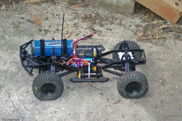

Sweet. I have the Honcho. I ran it stock for awhile and it was awesome. I've always wanted to try a sensored setup so now I'm running a Ezyrun 21.5T motor with HUGE 5000mah 3s lipo. Goes all day! Got the MMP in there.
Anyway, I've always wanted to try an outrunner in it too. There's talk on rccrawler about one in production, so I plan to wait till I hear all the goss about that. It's a pretty tight fit in my honcho so the motors really have to be 540 can size.
Let us know how your selection goes.

traxxasbasher13
03.23.2012, 05:29 PM
That battery is a little too big for the truck lol. I ordered it yesterday and paid for the faster shipping form Hong Kong so it should be here in a week or so. I will keep you updated and I put a link in my signature to my build if you want to check it out.
