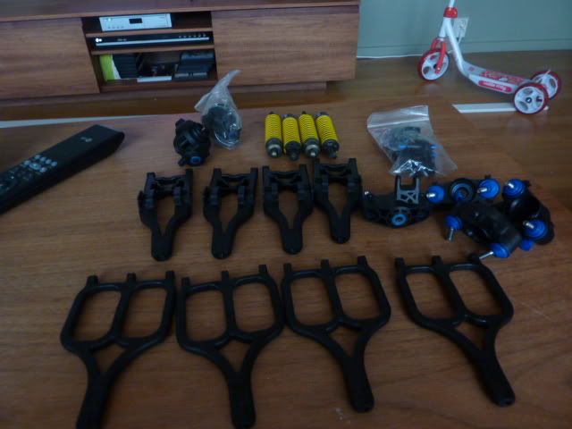

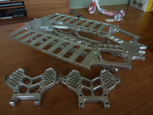

its time to build a new truck.
i have two kids and they love my "BIG" truck(FLM MAXX)
of course will i build a truck to my spoiled kids...
i want the truck bulletproof, but i want it to be cheap...
where should i put the money?i have plastic arms and driveshafts because it cheap and easy to change when they crash, but some parts should/must hack a crash.
i have:
-FLM chassi
-FLM towers
-ofna shocks
-stock a-arms
-stock plastic driveshafts
-stock diffs
-stock carrier(?)
-stock wheels
-what kind of bulkheads should i choose? is the stockplastic bulks okey or should i buy some in alu?
-moter/esc options for a slow BL truck? i want them to grow into the speed.
maybe run it with 2s paralell and the change to serie?
thanks guys..
