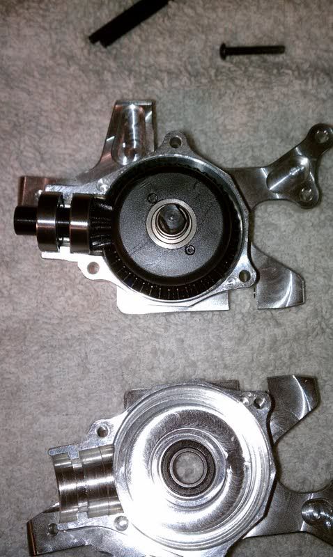

OK, Heres the issue. I have a set of FLM hybrid bulkheads and a set of ofna hyper 7 diffs.
I took the ofna hyper 7 diffs apart and put the outdrive shafts in so the front axle driveshafts can hook up but after assembling I have another issue. The pinion shaft that comes out the rear of the front bulkhead has a flat spot on it instead of a hole through it so I can't use the steel center shafts that came with my FLM Emaxx which is part of this project as well. I'm speaking of the shaft that goes from the front axle to the transmission.
I'm wondering if anyone knows or is aware of where I can get a pinion that is 13 tooth and the teeth are spiraled so they'll fit the 43 tooth ring gear and the teeth will mesh properly ?? Any help would be greatly appreciated. I'm not expecting a quick response as this is something the more advanced rc guys are doing so it may take some time I'm figuring so hopefully I can find something soon so I can figure this out. It's like a blockade keeping this project from moving forward.
Here's some photos so those who are interested can see what I'm referring to.

Well I think I figured it out. The diff fits but I didn't realize that the pinion shaft was larger so I'm going to order a set of cvd cups for the front and rear pinion shaft. I had to order the 1/8 scale size and set screw to hold the axle on. I'm curious as to what wouldn't fit on yours ? Was it The diff housing that wouldn't fit in the housing or were the bearings the wrong side ? Post some pics if you have the time please. I had to put larger bearings in the car for the pinion shaft that outputs to the axle shafts that lead to The transmissions.

1.50in or smaller ring gear will fit The bulkheads I read somewhere. My spiral geared ones fit in the hybrid bulkhead were just trying to get the outboard axle cups to fit.
