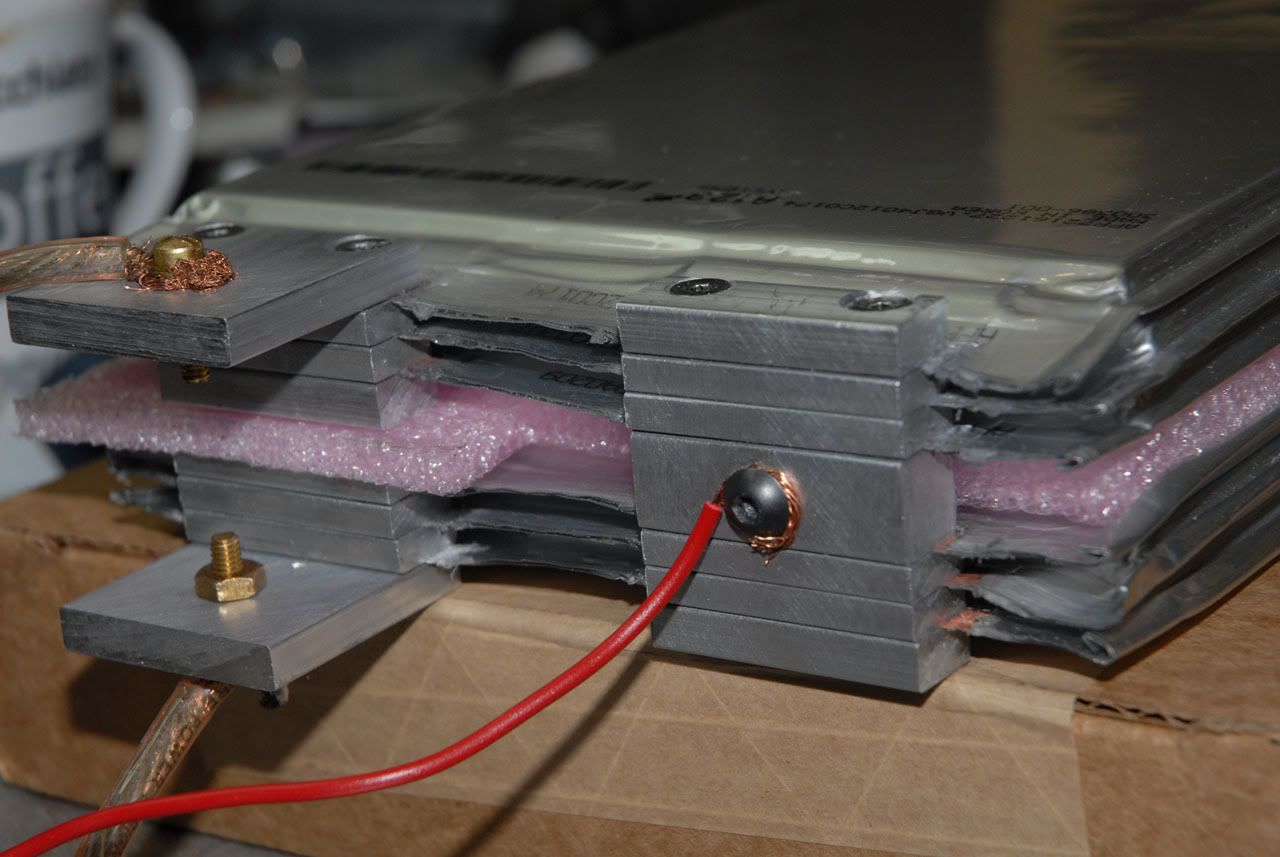

Is this a viable option to soldering the tabs? Hmmm..........

In the meantime, a better solution to tab soldering? Tab Clamps! I kinda like the idea. This gives the user the ability to take the pack apart, should the need arise. Also, high discharge capability, provided the design is right.

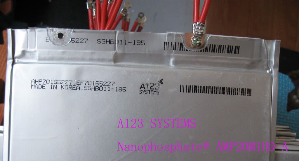

After alot of research, the "good" high discharge A123 20ah Polymer cells say "Made in the USA".
