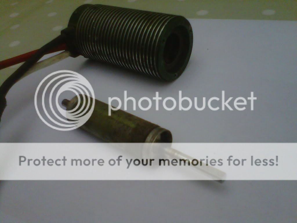

The bearings went in my 1520...bad news is that they got inside and the rotor laminate is damaged i think..
ive popped in a new bearing and it still grinds...
is there anyone at Castle that can help ?
or someone who can repair it ?
pic below

Maybe you could try to remove\cut the damaged part of the wrapping on the rotor.

If you've still got grinding then there's something else still wrong. Other bearing, bad bearing parts inside motor, bent rotor shaft. The wrapping is carbon/Kevlar thread with expoxy holding it together like a high strength fiberglass. I definitely wouldn't go cutting any of it off and would be prepared to rebalance if attempting a repair.
Idk what Castle has as far as motor repair capabilities, wrapping and balancing rotors may be something that's only done in their factory or for prototypes. I know Castle wasn't keeping many spares after the motor sale. Neu might be willing to help you out if Castle can't.

but like the post below...i may try and replace both bearings and see if that helps...I must admit...the rotor laminate seems pretty ok..
I cant see any obvious scoring or anything that would foul the inside of the motor.
