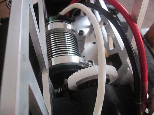

Well I'm a bit over standing backflips so my Flux is in a conversion mode as well.
At present we have:
Alza 5B Chassis Plates
Castle Neu 1717 Motor
MMM XLV2 ESC (due in tomorrow)
Transmission is all upgraded gears (HD Lightweight) Delrin Spur 16/48 gearing.
Have a 5SC Body, Body Posts / Bumpers and Wheels/Tyres on order but am at a loss how to mount it all. Looking at Rummy's build among others they all have some way of fabricating parts to suit, stuff I just don't have access to. Have contacted Alza but he needs drawings to fabricate something, which I haven't had a chance to do...... dilemma is do I cheap, buy a HK clone Baja, nick the Shell / Wheels/Tyres and Wing off it, make this a 5B with a cheaper ESC then convert the Baja with the MMMXLV2 as the centrepiece or is it workable to mount the 5SC bits without a machining shop?

I would think the front and rear body mounts wouldn't be too hard, just raise them up or reverse them if need be to line up better on the body. As for the sides, I think you might be overthinking it a bit. You'd be suprised what you can do with some flat plate and "L" aluminum pieces, a hacksaw, and some files or a dremel with a sanding disk to clean up the edges. With that you could make up some mounts for extended Traxxas body posts to use for the sides. Might not be quite as polished as a cnc'd part, but you could remake them a couple times until your happy for alot cheaper with stuff you bought at home depot.
