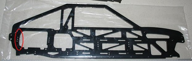

Yes you will. I'm not even sure that the 1717 will fit length-wise with the TCS TVPs. The 1520 should be able to be mounted with a bit of grinding for to account for the length over the motor over the stock.
You can always grind out the Flux mounts to fit either the 1520 or 1717. I've got the GCM mounts for a 1520 as I was planning on mounting this up, but ended up putting it in my truggy.
Originally Posted by NickRummy View Post
I want to run a 1717. I've been reading up about the Alza mounts for them. What do you guys think about using these mounts with the TCS TVPs? I have a 1520 right now but bigger is better right? .
FYI, I'd just go ahead and get the bulletproof Flux diffs, you *are* going to break the standard diffs very quickly.

The 1717 is actually shorter than the 1520 according to Castle's site. Not by much, 3/16" or so. I already ground the mounts for the 1520, you can see it sitting in the second picture in the OP. I'm just thinking about going to the 1717 now instead of spending time on the 1520.

Is there even enough room? I took off quite a bit for the 1520 and the 1717 is a lot larger in diameter.
How do you like the 1520 in your setup? Isn't that what you're running? What all did you have to mod on your TVPs to do it?

Actually I ran the 1800kv in the 5T as I put the 1600kv in my truggy. I was running the 1800 on 6S, thought it ran cooler than the standard 2200kv. I basically had to grind out the rear of the motor cutout area of the TVP (see attachment, the area where the red circle is).
