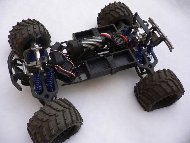

What's new ? :
- UE diff (6 spyders) with black anodized cases
- UE Monoblock black anodized
- Proline Ford F-650 body
- IMEX Swamp Dawg tires
- Turnigy 4500mAh 3S2P 30C LiFePo4 packs
- and some minor mods...
I made an Excel file in which I listed all the parts needed to build this maxx (screw by screw, bearing by bearing, washer by washer...), where to buy them and how much they cost. PM me with your mail if you want it.
I will post lots of pics of the 6s build tonight
It's time to test it now !!

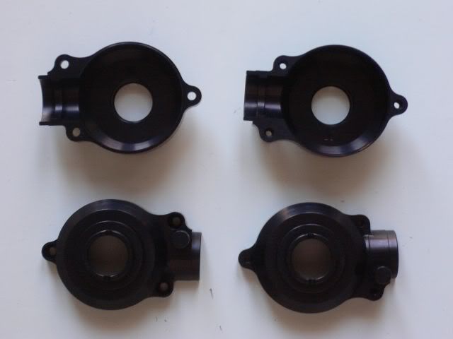

The first step was to anodize some parts in black to match my color theme. It's 1offRC (http://1offrc.com/) which did it, they made a great job and their service is excellent !

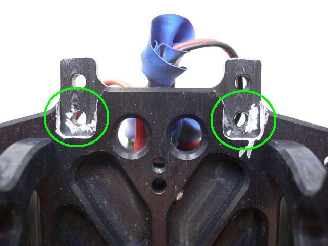

The Monoblock didn't fit well the FLM 3905 chassis, I've had to dremel a bit the 4 bottom screws (chassis braces side) of the Mono and the rear notches of the chassis :

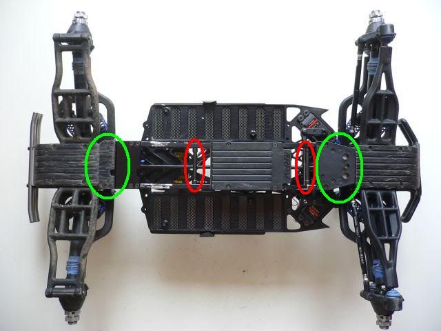

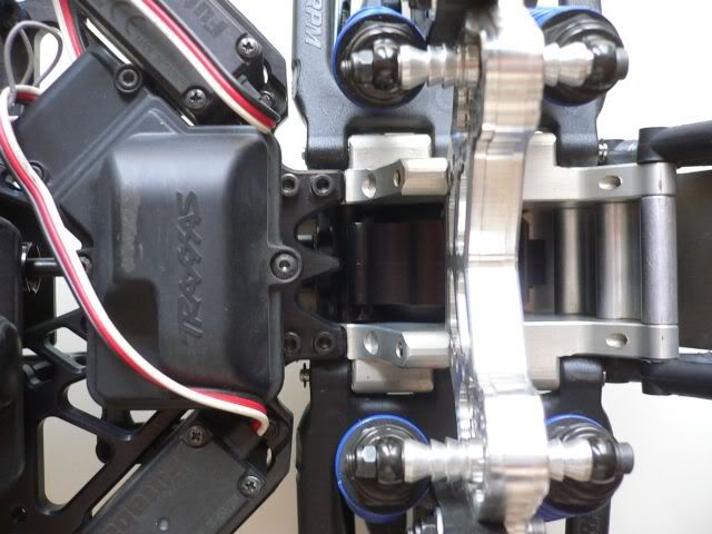

- I added protections (to flatten the bottom of my maxx and to hide the silver color of the ti skids) and chassis braces (to reinforce the chassis - I know it's pretty useless but I like the idea ):
Before
After
