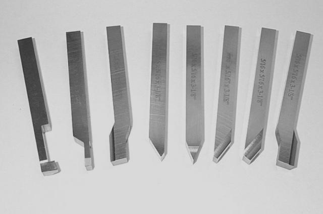

Since you're cutting aluminum, tool steel is your friend... time to play on the old grinding wheel.
First tip, use an aluminum oxide wheel for grinding tool steel aka HSS.
Silicon carbide wheels are normally only used for cemented carbide bits, and super-hard materials.

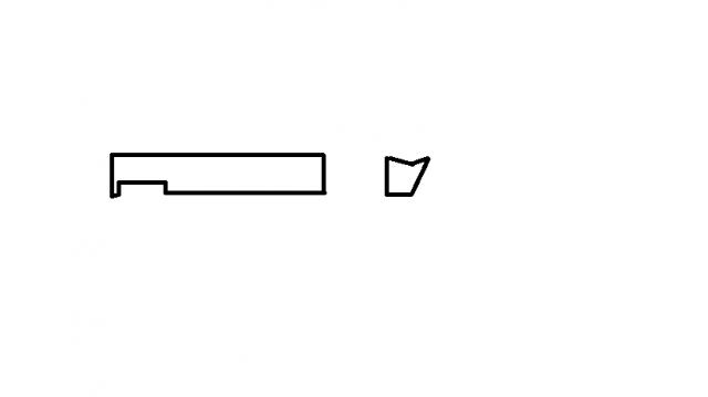

Form your relief so the chip material 'flows' as shown on the end view of my super-professional illustration, see tool bit on left of photo. The actual cutting width can be far less than the space, you'll go in a little, then pull the cutter away from the chuck, repeat til you have your proper ID & width. I usually use a dial indicator to know the depth of cut in a counter-bored hole.
The hardest part is measuring the bore inside the 'lip', if you have a junk pair of calipers, carefully grind away a relief on the inner measurement end of the caliper jaws, to look much like the cutter you used, so the measuring tips fall inside the lip, make sense?
Tool steel is cheap and you may have a few chunks lying around already, you'll need no more than 1/4" or 3/8" HSS blanks.
Use a silicon carbide stick to dress the wheel to the profile you need.
Standard wheels are 3/4" wide, so you'll want to cut a step in the wheel for grinding narrower gaps in your HSS bit. No need for fancy tooling here...

Dad wanted to buy a inside grooving tool with removable cutting inserts. I figured I could make what I needed using some stock and the welder. I only need to cut a groove 1mm deep 4mm wide. I figured I could whip something up, basically like a chisel point that could be advanced very slowly into the material and it would cut a square shoulder on each side. Otherwise if the cutting surface is angled I would need 2 tools, and would have to make them quite narrow to allow them to track along the 4mm groove. Not sure if that makes sense, I will have to draw a diagram.

Yeah I follow, I actually wasn't thinking much about the small scale, but you can take either a well-used endmill, or even a decent standard drill bit.. so that you're starting with a round profile.
And in this case you're more likely going to use a dremel with a stone wheel to shape your cutter.
The examples I gave above also both show angles, which is wrong.
You'll need either a dead straight (along the long axis of the bit) edge, or an inverted "M" shape to get square inside corners, so that only the actual corners are making the cut.
Not critical for a bearing seat, as bearings have a slight radius on their corners, but more critical for touch-off, and bore depth measurements. I don't recommend grinding your cutting face to the 4mm width, you'll get corner chip-loading, rather you should do more like 1 or 2mm and move the cutter 2 or 3mm to get your cut, working your way in to get your final ID.
In other words, I would't try to take the full bearing width, OR depth in one cut, this is difficult to explain but I hope it makes sense.
You must always allow the chip a place to go, one little chip load will snap your tip off, and you may just have to re-grind your cutter. But worst case is you'll ruin your finish dimensions and have to start over with new material, which sucks.
