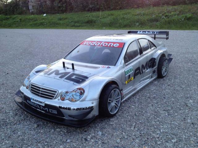

I found a used 1:5 onroad body in good condition. I would have prefered a Porsche body but at this time there were no good offers. So i chose a Mercedes touring car body which is depicted here next to my 1:8 and 1:10 bodys.

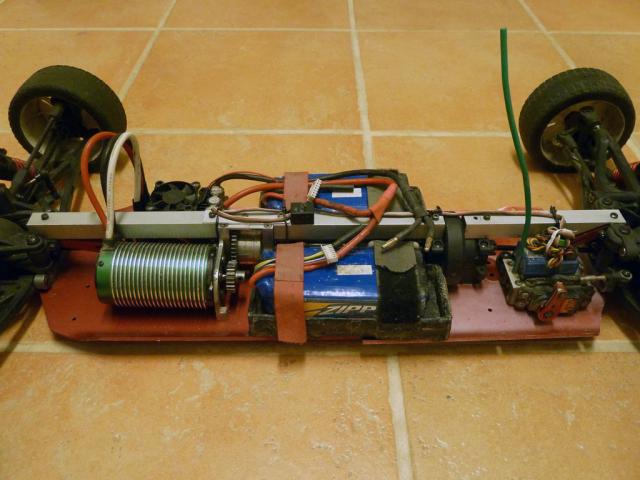

Next step led me to cut 2 Mantis truggy chassis and joining them to get the right wheelbase
After this step i chose the bruhless components and where to place them on the chassis. Which resulted in this first test layout.
ESC: Xerun 150A Pro
Motor: Castle 1520
Batteries: 2x Turnigy 6s 3600 used in parallel
Steering Servo: Hitec 5955TG
As i was never able to come up with a well balanced custom long CVD (on my previous projects) to join the center diff with the front axle i decided to join those with the aid of a second blocked center diff which required only a short custom CVD/bone. A rather unusual and not very efficient solution but as of yet it has proven to be reliable.

With mounted body
After a few test runs with the castle 1520 motor i stepped up to the Castle 1717 motor which was an easy fit when paired with a 22t pinion.
Depending on the batteries i choose the wheight ready to run lies between 6.2 and 6.4Kg (13.7 - 14.1lbs). I'am using lighter Zippy 6s 2800 paired in parallel (depicted on the image above ... the blue ones) or heavier Turnigy 6s 3600 also paired in parallel.
Gear ratio is 1:8.4 with a calculated top speed of 93km/h (58mph) without taking into account tire balloning. By changing the axle ratio from 42/10 (truggy ratio) to 42/12 (buggy ratio) i can augment speed to 110km/h (68mph).

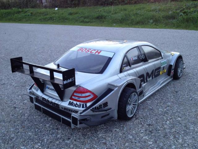

Track width is to wide but still works using the mercedes body

I love the looks of the car! I like the track width, I think the wheels look good sitting out a little.
