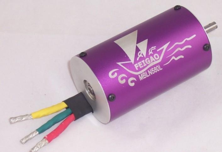

I was looking over some rpm charts for various BL motors and noticed they can have quite a high amount of winds, which brings the kv down to as low as ~500. On these motors, is the sweet spot still 35k-38k rpm? If so, then they must be designed primarily for high voltage. For example, motor with a kv of 500 would need 76v to reach 38k rpm. I'd imagine the current would be quite low though.

Yes, in a car, the "sweet spot" is usually around 35 to 40k even for those motors. Just remember, most of these are intended for planes. From what I understand, the motor on a plane doesn't spin as fast. I think around 25k. Not really sure why.

Planes need to run limited RPMs because of the propellors that they use. But, they can use gearboxes on the motors, so there's no reason why a plane can't have a motor spinning faster.
Are these motors with a kv of 500 outrunners or (standard) inrunners? Outrunners function differently, and work with a much lower RPM.

Well, the reason I ask is I was thinking of doing a direct motor-to-diff drive using a lower rpm motor, but if they are still supposed to spin at such high rpms, then it wouldn't be a good idea. I was also thinking of using one of those inline planetary gear drives, but they are quite expensive. I was shooting for a semi-realistic car where the motor is in the front, followed by the "tranny". But, it looks like I'll still be using a spur/pinion arrangement.

The ones I was looking at were from the Feigao charts, so I assume they are inrunner types.
