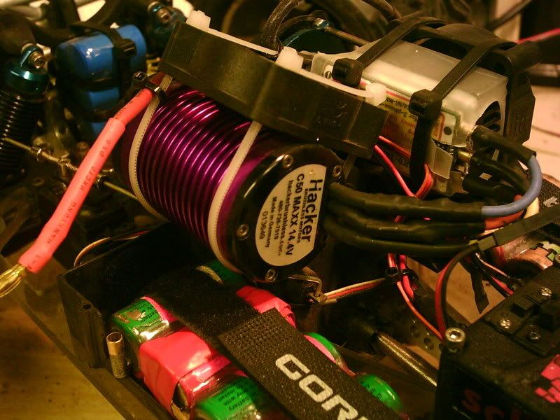

I'm running a Hacker C50/Shulze in my Maxx.
can anyone tell me if it is safe to run more than 14.4v through this Hacker?

14 cells i hear is pushing it, but you'll survive. 16 cells is a garenteed burnout.

If you try more cells, gear down a little. You should be safe. I wouldn't go over 16 cells, though.

The 9L or 10L will give a bit more torque. The 9L is great for 12-14 cells, while the 10L is nice up to 16 cells. If you really want torque, the 7xl is quite a beast.
