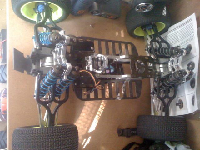

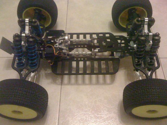

Hi all,
First of all, let me say that this forum is more than an inspiration!
Recently, and finally, I bought the slipperential.
After some brainstorming and some hours on this forum, I found my way to mount on my Gmaxx.
But now I have a problem... the dogbones!!!
I had tried to contact rcalloys.com but they are no longer in business.
Can someone help me find a place to order them or a way to homemade something that can work?
The front dogbones is around 30mm and the rear one is more or less 173mm.
P.S. Sorry for my very school english
Thanks
Marco

Others here may have an answer - but those are tough lengths to find - very short and very long. RC Monster Mike right here could make some for you if you don't find them elsewhere:
mike@rc-monster.com
I've made a long dogbone here:
http://www.rc-monster.com/forum/show...t=26979&page=3
and others have done something similar with thick-walled steel tubes or by drilling aluminum or steel rod.

30 mm dog bone
http://www.activepowersports.com/pro...d-HPIA555.html
I could not find a 173mm dog bone, but I did find a 172mm dog bone
http://www.yeahracing.com/catalog/ta...01-p-2399.html
I hope this helps.
