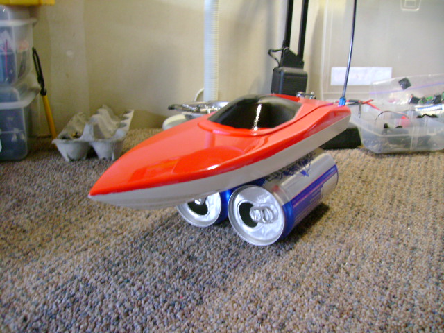

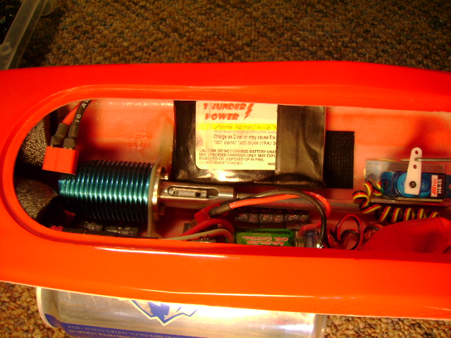

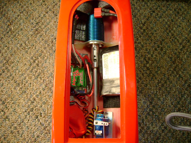

Well I have never seen a brushless boat on this form, so I figured I would post mine:
I bough the hull from here: http://206.206.85.209/xtdoc/Details....H&store=mhzusa
I am using a Mamba 25 ESC, with this motor: http://www2.towerhobbies.com/cgi-bin...?&I=LXJAB4&P=7
I have it set up with a 2cell Lipo and 33mm carbon prop. It very small, fast and a lot fun.!
Enjoy!

Very cool. It says it is just over a foot, so it should be great in ponds/lakes where there isn't very much room.:027:
04.17.2007, 11:13 PM
Looks very nice. Sure is a lot simpler than a car! How's the runtime? I've heard that boats can suck some serious current...
Team X
04.18.2007, 10:21 AM
It is great in small golf coruse ponds
The run time with the lipo is about 10 to 15 min, that is with doing a lot of high speed runs
04.18.2007, 10:33 AM
Do you have some sort of soft cutoff so you can get it back to shore when the battery dumps? Unless you like to go swimming. :)
Team X
04.18.2007, 11:05 AM
No, The secound the ESC cut's off I can tell and bring her back in or I use my other boat to go get it
04.18.2007, 11:46 AM
Yeah, I suppose you could wait a minute or two after the ESC cuts out to let the battery voltage increase a bit and then get it running long enough to get it back...
Team X
04.18.2007, 02:19 PM
Yep, that's what I do
