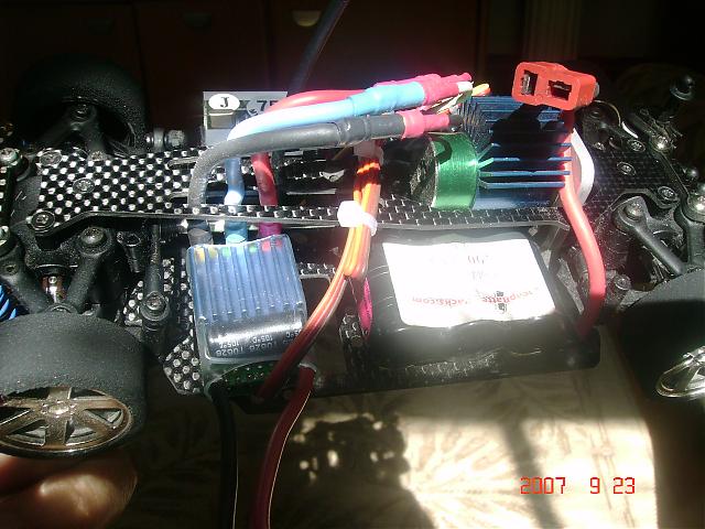

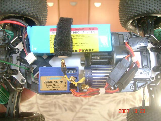

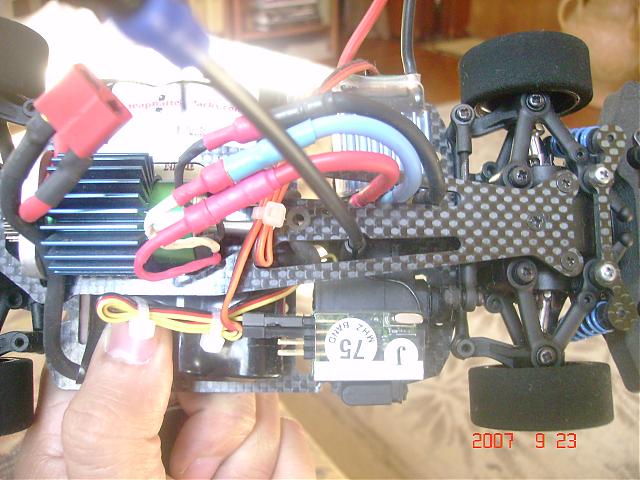

I'm not hyping the ESC. Here are some picture. I might have the diff set up right.

lutach
lutach's Avatar
Posts: 5,139
09.23.2007, 01:53 PM
More pictures.

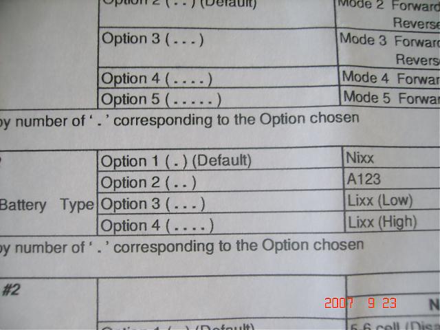

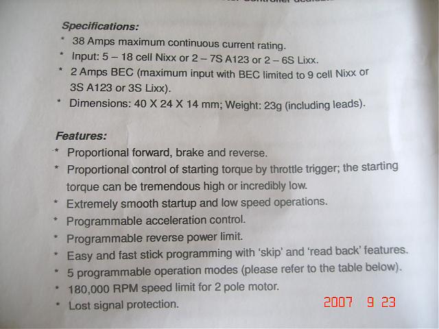

Instructions pictures.

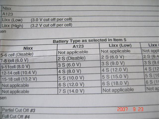

Some more LOL.

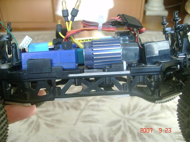

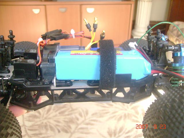

Here are some pictures of the MLST I'll be using to test the ESC.
ID:	3297   Click image for larger version
ID:	3298   Click image for larger version
