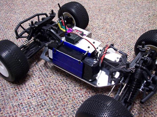

Well i wanted to make a thread with just finished (and almost finished) pics of my Hotbodies LS10. Ive been tracking my mambamax esc and CC bec and they'll be here tomorrow (friday), after it arrives ill just be waiting on my package from mike that i ordered today (duh i forgot to order my pinions)  So i guess itll be monday or tuesday before it get to drive it.

Very clean conversion! With a 9L and 3s Lipo, it should run very well. Only thing I'd be worried is the thickness of the motor mount.

Yes, the motor mount does look a little on the thin side. I'd use at least something 3mm or thicker.
But yes, thats a very nice conversion. Nearly looks factory...good job.

its 1/8th inch 7075-heat treated to T6, i think the picture is decieving i barely have enough motor shaft sticking through to reach the spur, and im gonna have to turn my pinion out just to reach.

Very clean conversion.
Two things:
first, replace the front dogbone by the CVD unit, because the stock dogbone fall off on a tight turn.
second, the pin, in the axle, who hold wheel in place, change it by something more durable, because you'll snap it every run. On mine, i've use an allen key of the same dimension of the stock pin and cut 4 pieces of this allen key with a cuter pliers. No problems after doing this mod.
You'll love this truck on a track, it's a beast in brushless setup.

wow, it looks like a very clean conversion. i feel like mine is cluttered now, although i'm taking up alot more room with batteries.

I read about the front bones coming out and i took mine apart already and put little o-rings and foam blocks in the cups to keep the bone centered and they FAR from coming out when to have the wheels turned to the stops, unlike stock which got pretty loose. Thanks for the heads up about the axle pins i already had to do that to my little mini-lst2 beacause i would snap a stub axle and loose the pin.
btw i weighed my truck as you see it and im getting just a hair under 5 pounds. is this heavy or light compared to everyone else's LS10s ?
