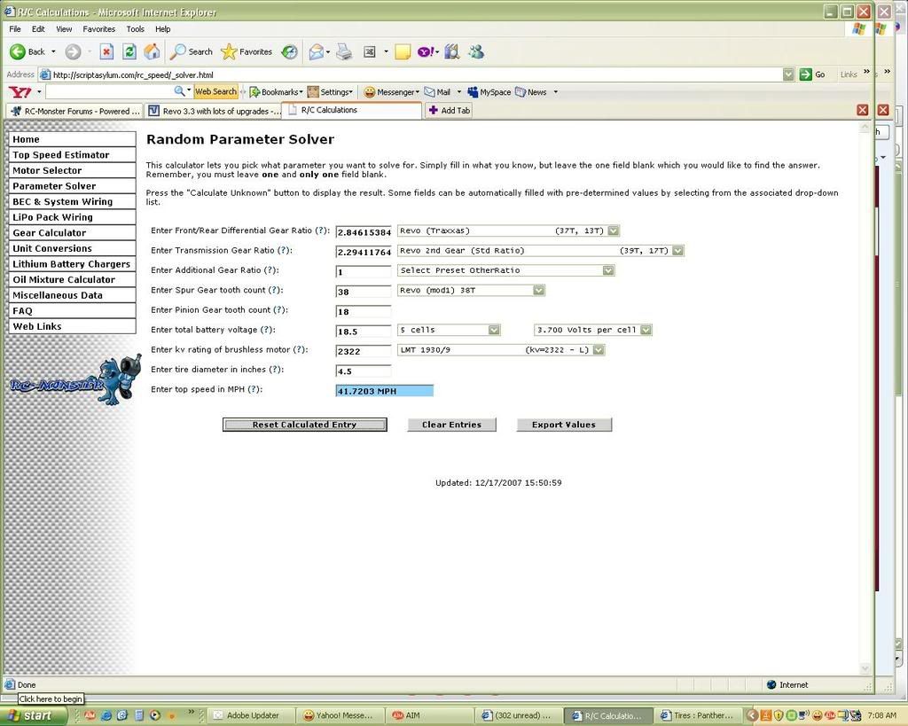

Hi, would this work in my revo?
5s lipo
lehner 1930/9
kontronik jazz 80-6-18
~8lb truck (battery incl)
EDIT: tire diameter so small because im using komodo dragon tires.

I would be a great setup...only thing is, you can't buy Lehners at the moment.

Since you are using a decently high voltage, I would use a Neu 1512 2.5d (kv=2000) for the high end, or a 9XL as an inexpensive option. Then, just gear up a tad. To help keep the pinion size to a more manageable level, you might want to consider using the wide-ratio gear set.
By the way, you can use the "Export Values" button and copy/paste the text into the post, like this:
Differential Ratio: 2.8461538461538462
Transmission Ratio: 2.111111111111111
Additional Ratio: 1
Spur Tooth Count: 38
Pinion Tooth Count: 18
Battery Voltage: 18.5
Motor KV: 2000
Tire Diameter: 4.5
Top Speed (MPH): 39.0499 MPH

I would say go for a quark over the kontronik, just because of startup and warranty issues. If you are only going to use 5s the quark is the best, next to an mgm. I use a quark 80 with an aveox motor in my tekno revo and the combo is great, stays cool too!

well id like to use the kon cuz no heat issues (quark) and wont kill pockets (mgm).
