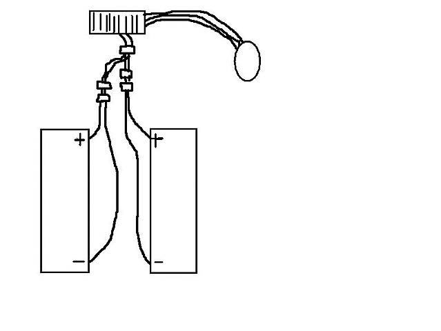

here is how i have them if i run 2 batterys
i have 2 batterys that each connect into the Y..how do i know if its series or parrel ?

here it is

Both red wires connect to each other correct? If so you have a parallel connector. This would give you 7.2v and 8400mah. You should run a series connector, like this:series adapter it will give you 14.4v at 4200mah and get the truggy going fast!

Not sure what you have there, but it looks like you have the packs wired in parellel.

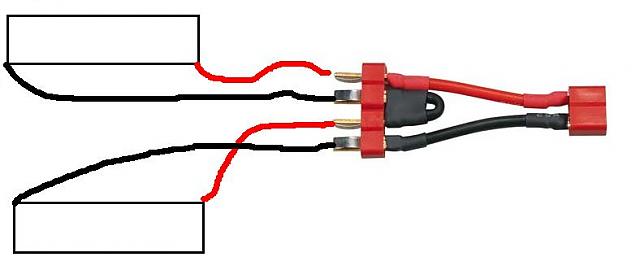

is this how i should do it ?

Thanks alot, i was looking at my Y adapter and it is solderd with the red connecting each other, so im going to re do it and make it where the postives connect .... will it harm the mamba max ? run times decrease ? how much more power will she get ?..im getting exicited now
01.05.2008, 02:20 PM
Yes, that is a series connection.

01.05.2008, 02:28 PM
right on... thats the way.
