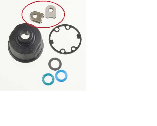

05.30.2008, 10:06 AM
The difference is this : Steel Spider Gear Braces (not used with Revo)
