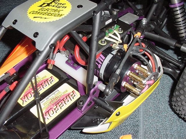

Would u pay $2835.00 for this E-Baja with Lehner 8hp motor, 150amp 4-10S Brushless Speed Control, 2 6S 6000Mah 30c Lipos, and 50mph.

Come on we all knew that a baja 5B would be converted sooner or later. That thing is pretty sweet needless to say, but the price reflects not only the material used but obviously their time as well. Lets be real here most of us would love to have it, but not at that price, because a lot of us could just build it on our own for less. Just a guess, but the buggy runs about $1000. The batteries are approx $400. motor $400. ESC like $500 and we will give them $500 for misc build materials, which adds up to about $2800 if we were to purchase and build this project. They probably got a few breaks on their purchases as a friendly slide, and Yea you could nickle and dime some of the parts, but that is a very real figure.
So is the purchase of this thing worth it? I guess it depends on how bad you want the E-Baja 5B(rare), and how limited your talent and resouces are. I would love to have that puppy in my toy collection, but I have enough projects going on already and that is more money then I am willing to spend at the monent. It will be a nice toy for someone out there. So if you have the money and your game for playing with a $3000 toy then go for it. I know that two of my SuperMaxx trucks have about that much in them already. So why not????

I was going to say that the batteries would not be able to supply the power to that motor... but a quick calc later shows that it would. Seems to add up as far as what components he used, let's just hope he never cheated somewhere crucial.

Looking at the pictures more after reading linc's post, the workmanship just isn't any where near justifying that price. The ESC is exposed to whatever can come at it, the motor connectors should be heat-shrink to protect from elements. It looks too much like a cheap hack job.
Also, on that motor at 22.2 volts it has the ability to pull over 300 amps, on a 150 amp controller, and 180 amp batteries? Wouldn't he had been better off going 12s, or am I missing something here?
It also seems to me this could have been done with a neu 1527 motor as well and if not then a 2200 series would surely be enough, I mean they toss some pretty stinking big and heavy aerobatic planes around so why not and at 300 bucks cheaper than the lehner.
