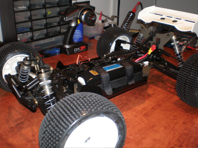

That's my X2 conversion Jnev .
I just drilled and dremeled 4 new slots in the chassis for the Tekno mount so i can adjust gear mesh .
Fits great , only thing because the mount is seperate from the diff ,when the chassis flexes it could stuff up the gear mesh so i braced the centre diff to the rear chassis brace which will stop the centre chassis flex .Pics below so you can see how i braced the diff.
I also have one of Mikes CR buggy mounts coming to try out in the X2
Finnster , the X2 has been run now down here in Australia for nearly two months . I know a couple of guys that have been running it and i think it won the Australian Nats .It has heaps more steering than the X1 , accelerates alot quicker and is holding up great .Flies through the air like an eagle . Also when i built my conversion the driveline was the smoothest i have built
I haven't run mine yet as i fried my MM when testing it out on 5s so i am waiting for the MMM V2 which i back ordered.
