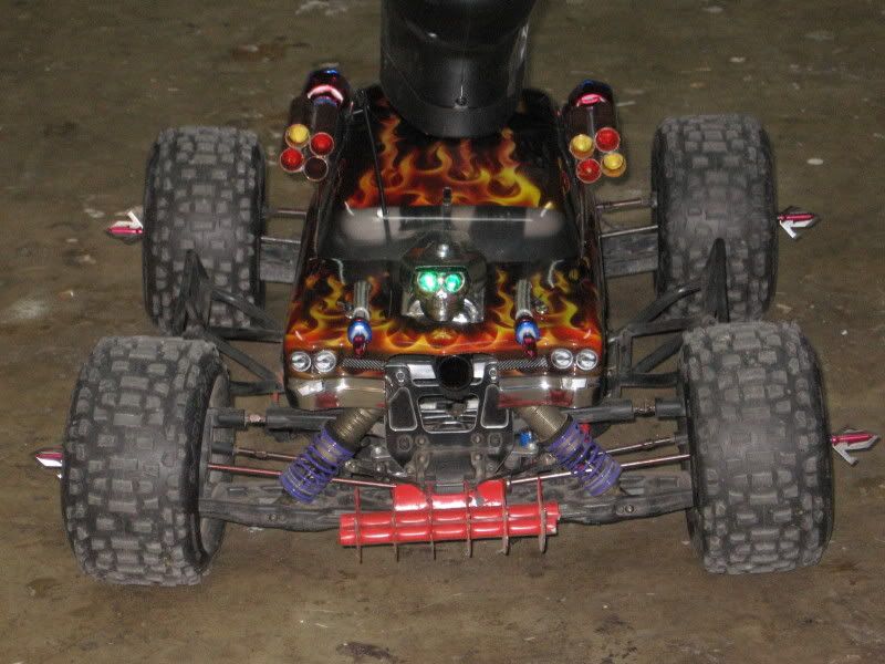

Here's what I'm bringing..
Nothing!.. Hahahahaaa..

Originally Posted by TDC57 View Post
Your on BIG GUY..: . BRING IT!
What's with all the steel braided hose? I had to take out your image link because it says this post was over the legal limit.
