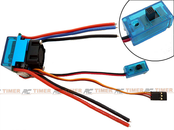

hey guys, i found these on ebay, and the one thing that makes them stand out to me is that they run brushed and brushless. they are also cheap which could make them appealing as a nice esc for 1/10 bashing. 4 cell lipo is also a very cool thing to have.
here are some specs direct from ebay.
i would love to get some thoughts about this thing from some of the more educated guys on ESC's from here. i swear, most of you have masters degrees in electrical engineering to do what some of you do.
http://cgi.ebay.com/ws/eBayISAPI.dll...m=120354459145
High quality
1.1 Output: Continuous current 40A, working current at 50A can last over 1 minute,burst current 60A.
1.2 Input: 4-12 cells NiMh/NiCd or 2-4 cells LiPo. (Note)
1.3 BEC Output: 6V/1A.
1.4 Resistance: 0.0006 Ohm.
1.5 Motor Supported: Sensored brushless / Sensorless Brushless / Brushed
1.6 Suitable Brushless Motor: 5.5T and >5.5T
1.7 Suitable Car: 1/10, 1/12 on-road or off-road cars / trucks for normal race.(Great power for 2S lipo battery)
1.8 Size: 31.5mm(L) * 27.5mm(W) * 24mm(H).
1.9 Weight: 30g(Without wires)
Note1:
For brushless motor, the ESC supports up to 12 cell NiMh/NiCd (or 4 cell Lipo) input; While for brushed motor, the ESC only supports up to 6 cell NiMh/NiCd (or 2 cell Lipo) input.
For 4-6 Cell Ni-xx: You needn't change the fan coming with the ESC;
For 7-9 Cell Ni-xx: You must change the fan because it cannot work with such a high voltage, so please choose a high voltage fan or supply the fan from the receiver (+6V);

Specs look ok, if a bit low. If specs aren't inflated, it might be ok running 4s on a low kv motor in a light 2WD 1/10 scale (max) vehicle; anything larger, or lower voltage, will probably exceed the low 40A spec. And it looks like it doesn't have a switching BEC, so if running anything over 2s, you'll need an external one or a receiver pack.
It's really hard to say though. There is more to an ESC other than specs: customer service/warrant, upgradability, smoothness, etc

The specs are very similar to the EZRUN 60A Esc (especially when they talk about the fan). I think that this is just an EZRUN.
