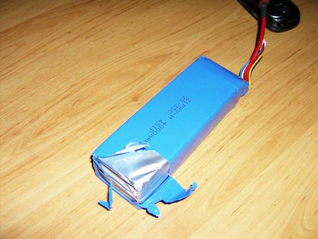

I got my new Zippy-H 4000mAh 25-35C 4S1P lipo in the mail today and tossed it in my Raze Buggy as soon as I got home. Right away I was impressed with the punch, and a second later the buggy lawn darted and the improperly sucured lipo shot out like a rocket. There are not any punctures in the pack but a couple good dents. Let me know what you think as far as if I should dispose of the pack or run it. Thanks.

If there are no punctures, I would try to smooth out the wrinkles.
Re-shrink it again before you run it though.
It appears like it might be ok.
If there are punctures, then those cells with holes are done.
Just be SURE it is properly secured. Looks like a close call to me.

seems to me ok. anyway the bad thing with zippy-h is their shrink.
double check the pack from puff and punctures. if not just buy good heat shrink

Well imo looks pretty banged up - Toast as far as I'm concerned.
Linc is the expert so check with him...

That is a bad crinkle, I wouldn't chance running it in a high power vehicle any more. There could possibly be shorts between the laminate layers where the folds are.

03.12.2009, 09:23 PM
I have run worse...
Try to carefully smooth it out. It should be ok. After a couple of cycles you will see if it gets out of balance from the other cells. If not you are good to go...
As far as pack damage goes, I have some test packs that I am abusing that have had a variety of issues. Most are torn foil, and I am having decent success with sealing them back up and running them...
If you want to send it to me with the rest I can eyeball it.

03.12.2009, 09:39 PM
Well the man has spoken. I'll smooth out the pack and give it a few easy cycles in the rustler then we'll see how the cells are. Thanks for all the responces. The people here at RCM really seem to have a great handle on the Brushless/ Lipo stuff.
