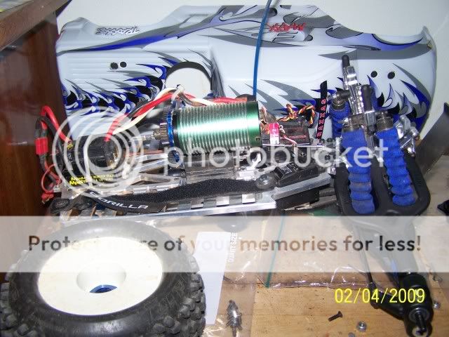

Here she is in her current state:
Here is the middle part of the trucks life CLICK HERE
Right now the only thing really stoping me is the drive shafts. I've had MIP CVDs, I've had the Revo Spec plastic, I'm just ready for some good 'ole stand by dog bones!! Where can the right size be had? I need a front center lengh for a FLM 3906 chassis (stock 3906 length) and four outside for a regular WideMaxx NOT 3.3. I would be fine buying a premade set or would I need to go through a company like RCAlloys or do you think Mike would make me some? IDK? FLM maybe? Any suggestions? Oh and I'm working with MIP dog bone cups. I come to RCM because well lets face it the wealth of knowledge here far surpasses that at TRX. I'm finding myself there much less often.

Glad you are here. There is plenty of help/knowledge here about brushless conversions. I would email Mike and ask him first. If he can do it he will.
You know can you measure the size you need? I might have an extra one lying around.
Mark

Dogbone sent. it should arrive no later than Wednesday, hopefully tuesday.

I'm waiting on a spool (only for the rear) and a few other items to arrive. I should be ready to rock next weekend!
