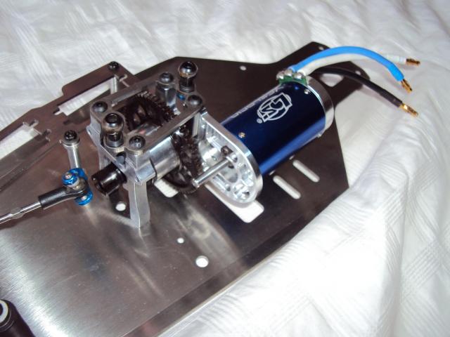

I did a little more digging, if Mike has a mount that fits it's gonna be the CRT.
I really don't remember any dominator builds.
Can somebody measure their CRT center diff mounts and post up measurements??

going to try the ultra mount i will let you know

Isn't it like a crazy huge 62t spur? that's what the crt is, I really have a feeling it's the crt mount.
mbx1275
Posts: 47
Join Date: May 2009
01.15.2010, 08:06 PM
51tooth
01.15.2010, 08:28 PM
Originally Posted by mbx1275 View Post
51tooth
well, that's what the ultra is, hopefully it works

Mount fits perfect so im resuming the build
