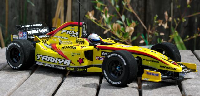

Gday F1 fans,
I have finally got acceptable footage of the car. Not yet dialed in 100%, but getting there.
She's running a brushed Mad Science Kyosho Krypton Krystal, 28/93 direct drive, ebay 300amp esc, lol, good for 50amp. Rubber Tamiya tyres, 2s 3000MaH 30c lipo.
I have 5700kv Castle Pro combo, but the car was way over powered. When or if my skills improve, i'd like to put such power in this car.
Graphs, photo and vid for fans of older Kyosho electric motors, Tamiya F1 and my ramblings, lol.
Pete

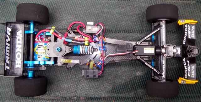

Gday,
Now I am trying 25/93 gearing and foams. I have the car at exactly 1008 grams with 40 grams of lead added. This is with HobbyKing 3000MaH 2s - 30/40c lipo. I think the car was really designed for the 7.2v NiMh stick pack with the extra weight??
Anyway, I am progressing steadily and falling in love with rear wheel direct drive, lol. First I went backwards by putting the powerful Castle system in it. I should have started the stock way, learnt to drive an F1, then put the Castle Combo into her. I am only getting more excited.
I got a bargain on the 04 module pinions 20 & 21 when she goes brushless with 5700kv. Standard pinion on F104 Pro is 25.
So for now, the Mamba Pro is in a Mini Losi Slider with RZ300 running G3 3s lipo. It is a beast. When I am happy with performance of the F1, and my driving, I'll make her brushless.
That's it for now, more photos.

I had alot better results with the car this morning . Much to my disgust, I returned to an Intellect 7.2v NiMh stick. It put on another 300 or so grams and now the car is a champion.
I think there are some lipos which have a hard case meant specifically for cars? I need one the same size as the NiMh pack and the same weight.
