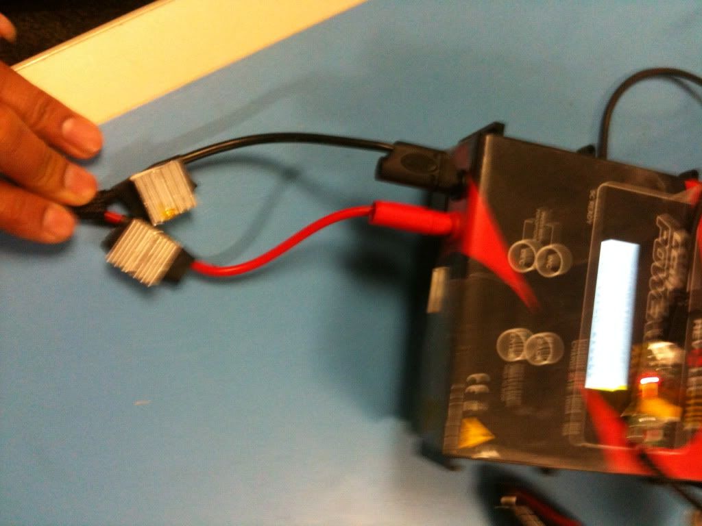

The one thing I don't like of the FMA setup, is the power cables with the blade fuses. Those little fuses get stupid hot at 40A. I added heatsinks onto them. You don't see that everyday.

feistyacorn
feistyacorn's Avatar
Posts: 279
05.13.2011, 10:23 AM
Thats awesome! Can we see a pic?

05.13.2011, 11:08 AM
Here is a iphone pic
Whenever these fuses go, I'll upgrade them again.
