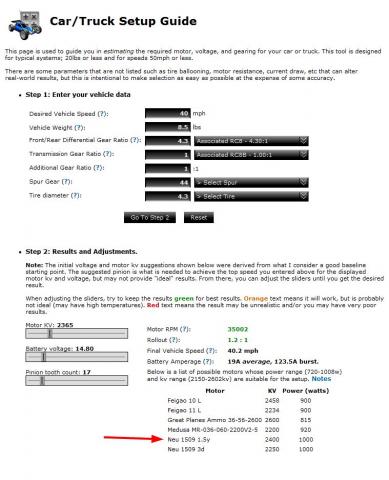

I'm searching the board / web a while to get an answere about the Neu 1409/1.5Y 2400KV
Does anybody use this motor in an 8th scale car on 4S Lipo ?
I like to use it in my RC8 to SC10 4x4 conversion
currently i use the Tenshock X 802 2400 KV
This motor is a beast ! I love it but for my primary use it does have way too much power.
90% the time i drive the car on an indoor carpet track @ rc-glashaus.de
ESC would be Mamba Max Pro or ezRun SC8 120A
On RC calcutaltions this motor gets "recommended"

If you want to run the 1409 in a 1/8 buggy-based chassis consider getting a lower kv and running something like 6S 2200-2600mah. It will help keep the current draw low and keep the temps down on the smaller motor. If you want to run 4S consider the Castle-Neu 1415 2400kv and MMP combo. You can dial back the power with torque and/or punch control if needed.
Well the 1415 does have way too much power
I'm not going to 6S
I want a motor around 1000 Watt
I will give the 1409 a try
