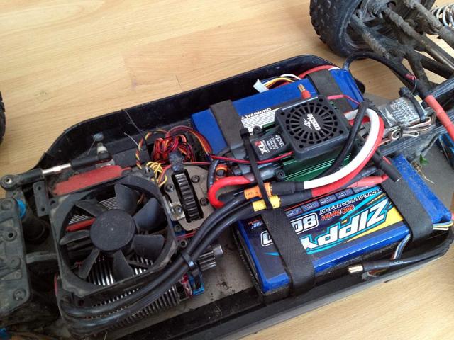

Pic of my setup:
08.16.2013, 07:48 AM
IMO
- Start power should be med at least - The inertia on this thing will be big.
- Re-check gear mesh.
- Get a BEC Pro - It adds a couple of wires but your ESC and servo will be much happier - I'm sure you must be using a digital 1/4 size servo... PS - Is the monster Fan off the ESC too! Pretty please get a bec :)
Extra idea - recalibrate / check radio/rx - Are you getting central drift so that it doesn't realize its at nuetral

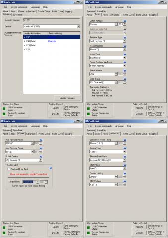

You may want to try these settings:
