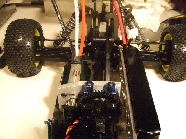

Build tips 60wt oil in the shocks and fill the diffs mine were skimpy on the fluids. :)
You can see Jays setup for the Canadian nats at www.jamminproducts.com he removed the front swaybar? and I believe this is his CRT.5 in this vid www.5spoke.com/site/op/media/...41/fileid/8012
Check out Mikes Jammin buggy mount I used a aluminum Jammin buggy diff mount I had and bolted my motor plate to the brake holes to get the plastic Kyosho spur to fit. So with mikes mount you can adapt the Kyosho spur and mount the motor with relocating the rear diff mount holes in the chassis. :032:

04.19.2007, 11:47 AM
Do you mean that you can use the Kyosho spur and Mike's mount without relocating the rear diff? That would be extremely cool!

04.19.2007, 12:03 PM
No you still have to redrill the holes with the wider plastic spur gear your center diff is going to be about 2mm longer I moved my diff over in the chassis and relocated all 4 center diff holes to get the battery closer to the centerline and make room for a 4s later but you can get away with just relocating the rear holes in the chassis. :)
04.19.2007, 12:18 PM
Poo. I really don't want to modify the chassis. It just makes things easier if I have to replace anything "in the field". It will be interesting to see what solution Mike has in store...
