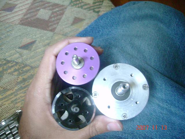

Here is a photo of my little motor next to a Lehner 2250 and Align 600L.

Interesting, I am looking for a different motor for my rc18t, do you think that It would be able to push a mini to around 40mph? The shaft looks to be the correct size, but the bolt pattern looks to small.

I think we can work something out for the 18th scale.

I think that motor might be more suited for an micro-t, it might get quite an exercize in an rc18!
Allthough, as long as you don't gear it over the moon it might work.

I would think that the micro t would prefer a longer can of this type of motor. It may get too warm when used for a longer period of time. Plus I am not sure about the strength of the shaft as I has a hole drilled in the end. It may snap with the high load ability of the micro t rear tires and trans.
Lutach, what motor is it, specs etc?

that hole in the shaft was certainly one of my main concerns as well, but on the other hand; a combination of the perfect slipper setup on the micro-t, and the use of relative weak nylon pinion i think you might get away with it. I think you might want to use plastic driveshafts, to avoid any direct stress on the shaft.

The motor is a high speed motor used in automation machines. It is rated at 15K rpms, has 8 poles, 57MM diameter, 70MM length, the shaft is 8MM in diameter and 30MM in length. I thought about rewinding it, but I have to get some time for myself to do that. It has a ton of torque and it is rated for 48 volts. I did hook it up to my Spin 75 with 36 volts and it said in the spin box that the motor's rpm was 25K rpm.
