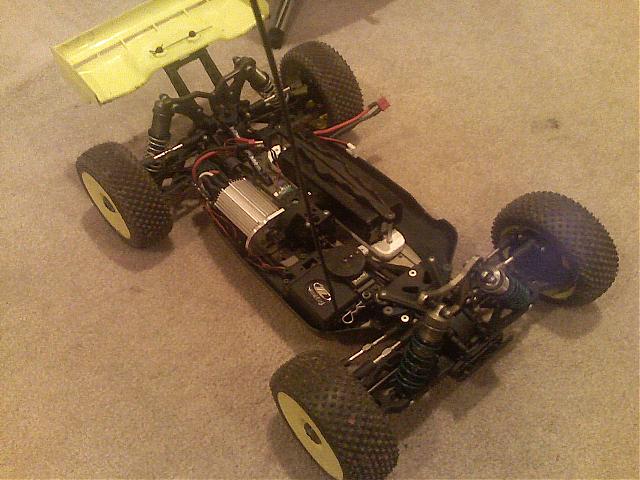

Got a pretty standard project here.
Chassis: Losi 8ght
Motor: Feigao 540C 8XL
ESC: Mamba Max
ESC Mods: 1x 25mm Novak Fan & 1x 2700Uf 25V Capacitor
Battery: 5000MAh 4S Zippy-H
UBEC: CCBEC
Gearing: undecided
More photos to come.
-Jeff

The battery tray itself was made from white-finished aluminum. I then covered it with black adhesive vinyl. the white didn't look good :) The vinyl was scrap from a sign-making shop. I was charged only $3 for about 4 square feet worth which is plenty to easily cover 5-6 boxes... The padding inside is "Darice" brand "Foamies Sheets" sold at walmart for $0.47 per 9x12" sheet. It does not have an adhesive back but when matched with 3M Carpet Tape (very thin) it adheres quite well! The lower layer of foam is running lengthwise with holes cut for the button heads to sit in (as pictured above) while the top layer runs width wise and up the side walls to better cover the heads of the screws and protect the battery which is also pictured.
Here are the mounts we made for the box. Pretty simple. They raise the box just enough to clear the radius of the chassis edge and the side guard dirt deflector thing.

Got it most of the way finished up.
Photos probably would have looked cooler with some clean tires.. :).. anyway... Only things left would be a better strap (notice the cable-tie loop on the current battery strap) and some better wire management. Maybe some heat-resistant braid for the wires passing next to the motor to the rec. box or something.

I ran it for a few minutes outside.. and decided to take some more shots. I kept my street-basher tires on. You can tell about half of the lugs are missing. Pretty crappy tires.. but I guess you can't complain for $20/set of 4 shipped premounted.
Tons of power! I can't imagine wanting more for any reason. Way more than you'd need for any normal track (unless you're doing a speed run or something). I hope to test runtimes tomorrow.
Low CG
Countersunk heads for rear battery box mount
Towerpro MG996R servo. Amazing bang for the buck. Behaves like an $80 servo. Actual cost: under $12 at Hobby City
BL 8ight, BL FT B44, BL FT TC4, BL FT T4
