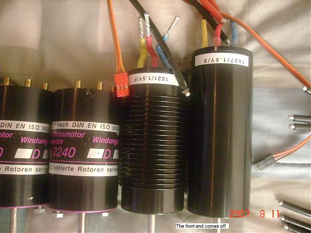

The can of my 1521 is not one peice. Here is a photo of the 1521 and 1527 next to a Lehner 2240. The only thing I don't know if it's screwed or pressed. It might be screwed as mentioned in a post above.

Serum
Serum's Avatar
Posts: 10,480
02.03.2008, 04:29 PM
Ah, yes i see, they are different indeed!
