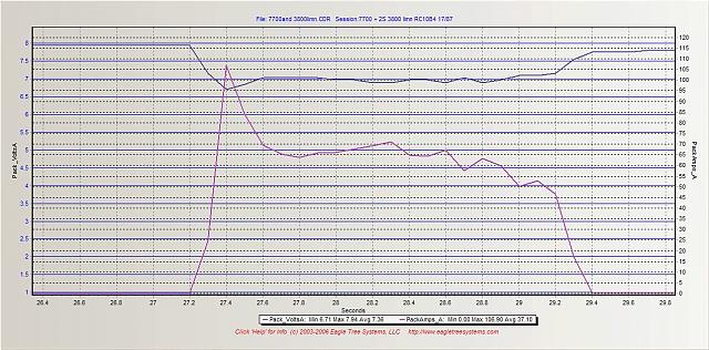

I think that one came from running a RC10B4 with a 7700Kv motor and feeding it with a Apogee 2S 3800mAh pack. That one was really hot, usually it hits 100A - 110A on initial acceleration. I'm attaching a graph of a similar run, I don't have "the big one" handy.
Keep in mind, this is with running "slicks" (worn out tires, haha) and they don't always hook up that well. Once I get some more grippy tires, I might see more consistent high spikes.
Sleeb
