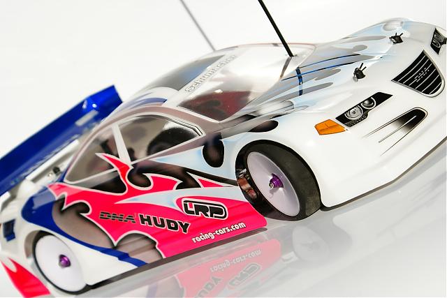

Slightly off topic but here are a couple of photos of my 1/10 car.

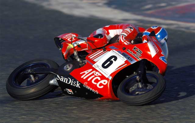

I'm catching up with a guy this weekend who has a vacume former and works with CF. We are working on a CF battery tray and side intrusion protection for the packs. I have attached a couple of pics of his work, all custom made by him, it's very nice.
