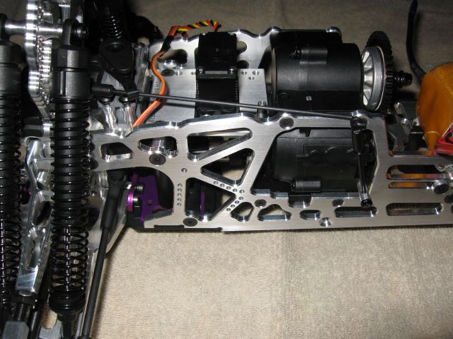

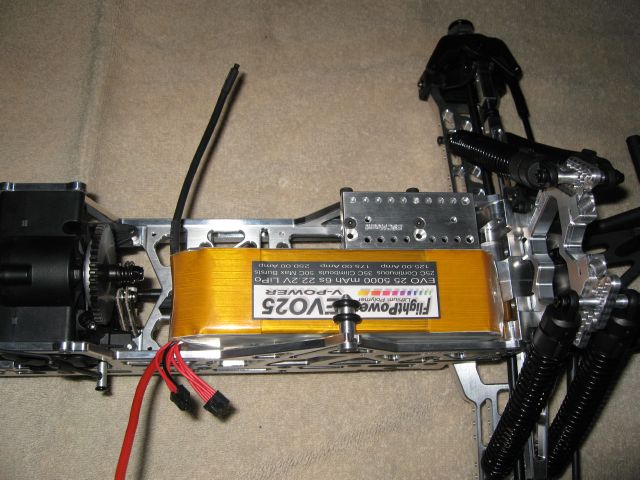

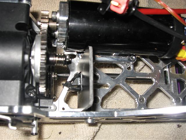

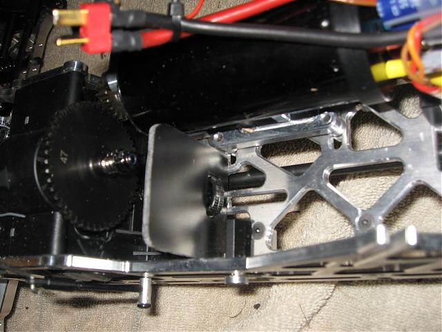

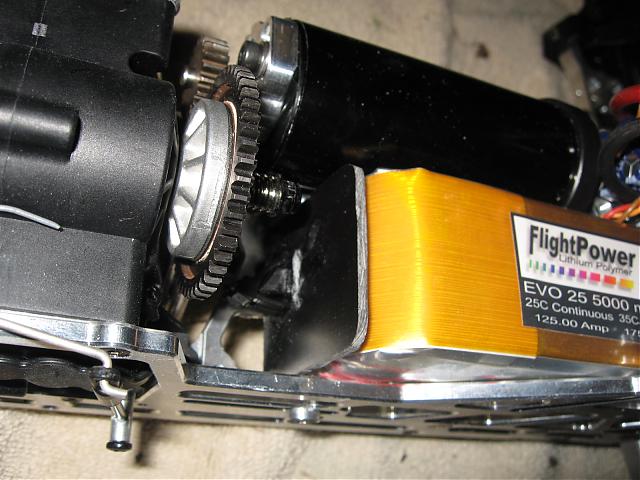

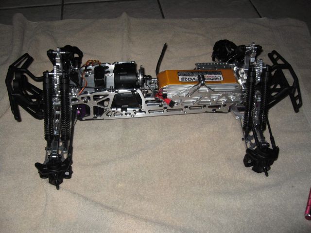

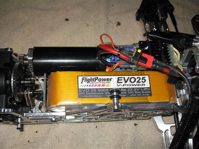

I made a barrier as discussed to stop the battery from hitting the spur during bashing. I used a dremel and cut it out of a piece of carbon board. I attached it to one of the posts supplied with the kit using zip ties and CA.
It is pretty sturdy and I feel confident it will hold well. The lipo is nice and snug in there now.
ID:	3912   Click image for larger version
ID:	3913   Click image for larger version

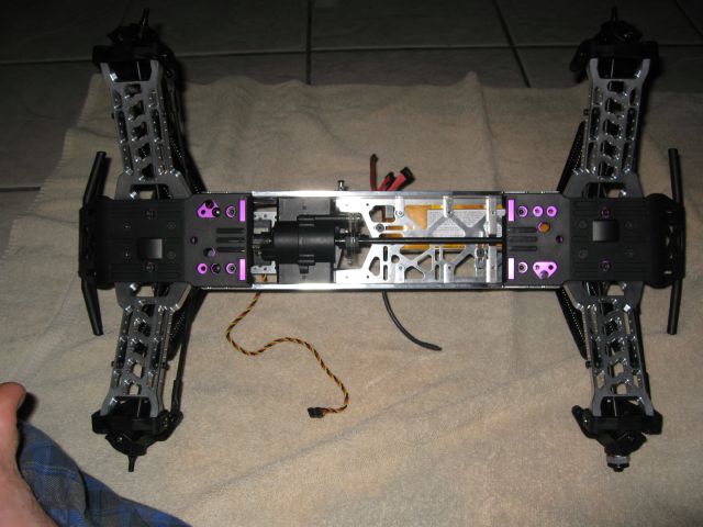

A few more
ID:	3916   Click image for larger version

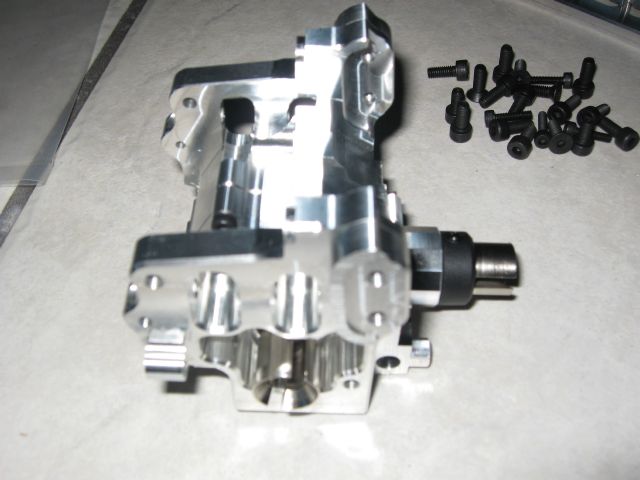

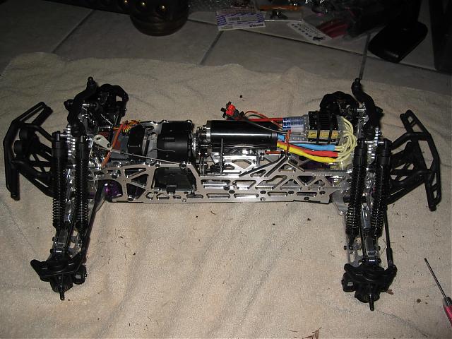

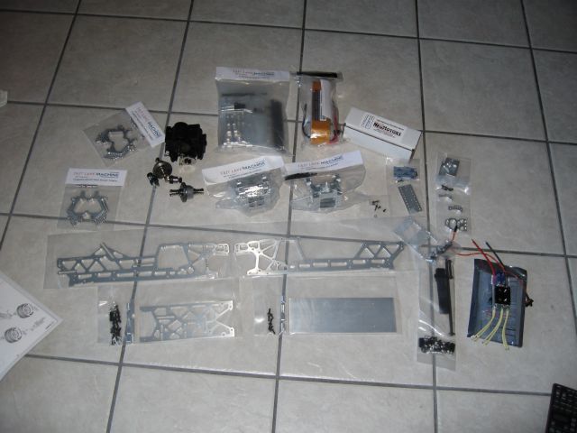

Now that I know how to reduce the size of my pics here are the ones I linked to earlier.
ID:	3918   Click image for larger version
ID:	3919   Click image for larger version
  (#58)
BashOn
02.01.2008, 02:26 AM
more....
ID:	3922   Click image for larger version
ID:	3923   Click image for larger version
  (#59)
BashOn
02.01.2008, 02:27 AM
and more.....
ID:	3926   Click image for larger version

Serious beast there. It really looks bad a$$ with all that FLM stuff.
Do you have a scale to throw it on? I'm curouis what the weight difference is between that and mine with the plastic arms and bulks.
