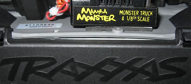

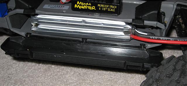

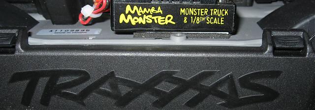

First battery box thought - DO NOT plan for 30mm high lipos. I stuck a small 4S pack in one side that measures 30mm exactly and it bulges the battery tray up on top and made the door a bit snug to close. There is enough pressure on the door being closed this way that I would be afraid that any body flex would cause it to break.
I'm going to stick with 25mm to be the max comfortable height.

Will post a few more pics in a couple of day with the batteries to show fit. But here's a pic with a 4S pack that it 30mm high. 1st pic - door closed with no battery. 2nd pic - 30mm high battery door open. 3rd pic - 30mm battery door closed.
