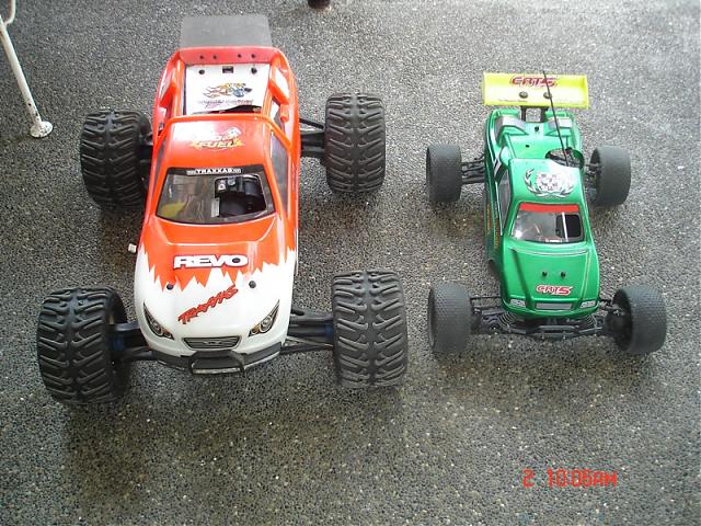

my bl conversion
karnaugh
my bl conversion - 09.11.2008, 12:44 PM
revo 2.5
9xl
mamba max
16teeth mod1 pinion
39T spur
2-speed tranny
14.8V 3500mah
temps after 5mins of hard bashing:
esc = 140F
motor = 140F
batt = forgot to check, but just warm only
Short vid:
http://www.youtube.com/watch?v=gY5uxjfSVIo

Very clean setup.
