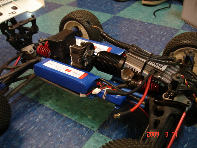

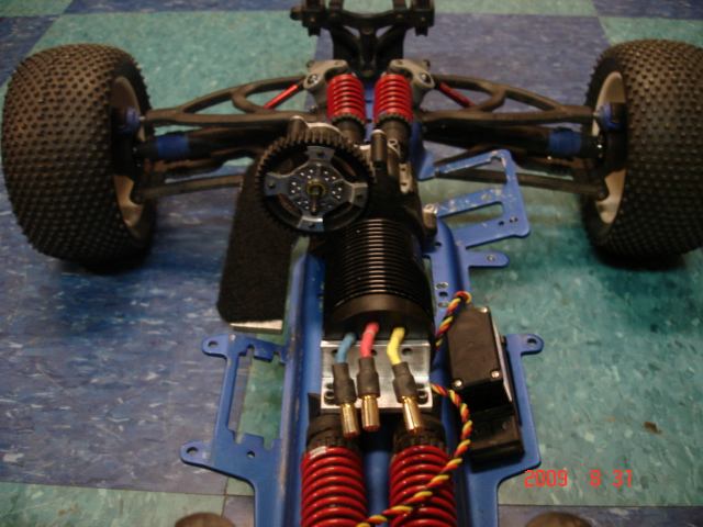

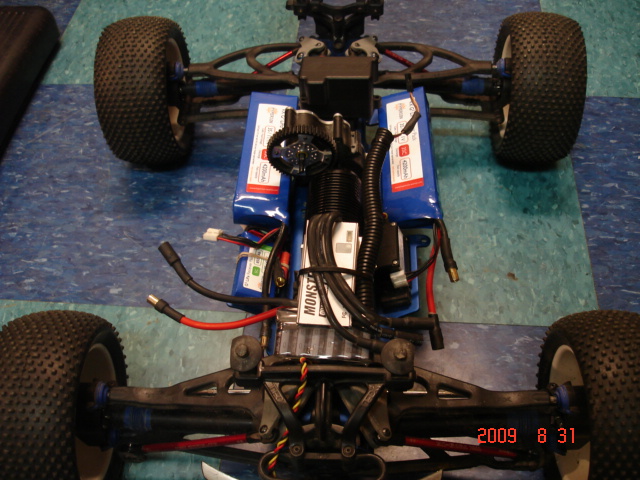

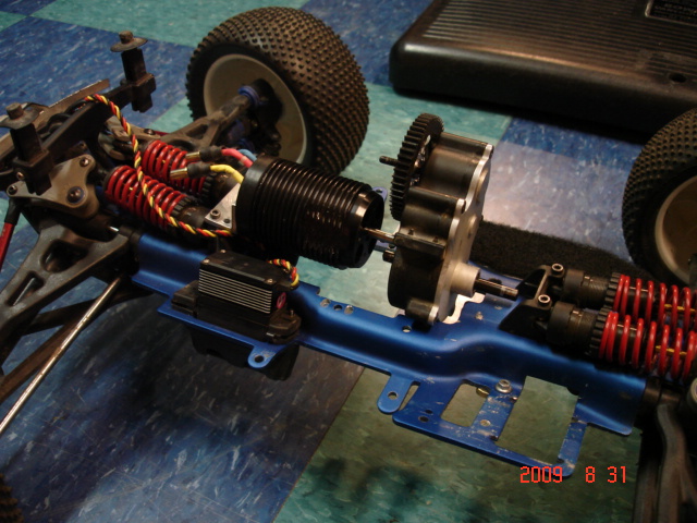

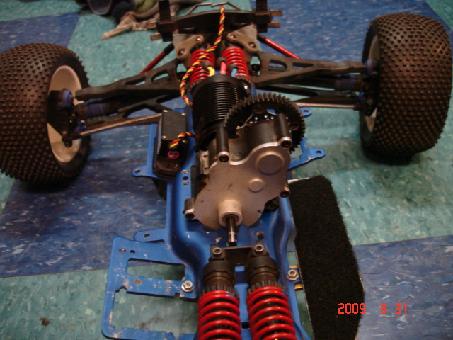

Another thought... I was just moving stuff around on the truck and was tilting the transmission 45 degrees one way and putting the motor centered in the chassis. Now if only I could make it work that way without heavily modifying the chassis to make room for it. If it could be done, then the motor would be centered, trans tilted to the left with steering servo on left as well, with Rx/rx batt on right side, and then twin packs on each side, should be 99% balanced then. Still thinkin on the ideas though.
I think what you're doing is great. Please share more and take some pictures.

On a side note, I posted some pics of roughly what I was thinking of when I said tilting the trans and making a mount for the motor in the center of the chassis, and lowering it. Check it out. Looks like a pretty balanced setup?
ID:	7646   Click image for larger version

The batteries would be mounted on CF angle mounts and will be sitting 1 inch lower than in the picture.
ID:	7649   Click image for larger version
yep, Watts is Watts but could there be something more? LOL
KV versus gearing versus final efficiency rating. I get that.
That's an interesting way to look at tranny position. I like that, but how are you going to secure it?
This should be good.
