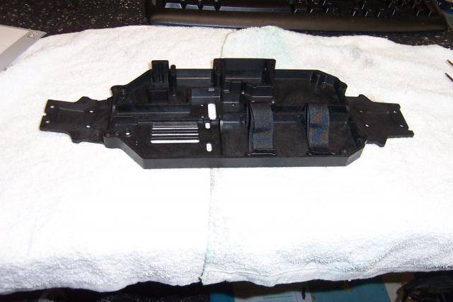

Since this thread was started for the VE8 i will post here . LOOK what i got today . Cornolio I hope you dont mind me posting this here . I figured since you have a good thread about this car here . We could keep all the talk about the VE8 in one place . For those who have the VE8 what is there flightmax hard case lipoe that will fit ?.
BDEBDE
I read somewere up to 150mm i think . I know the thunderpower 4s 500- HC fits . But they are not as wide as the flightmax . I just measured the tray. I got the following 140mmx 49mm. But there is small bumps that can be fieled out to get a 50mm width pack. So depending how accurete the flightmaxx measurments are .
Here are the first pics.

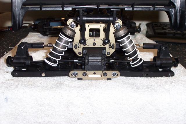

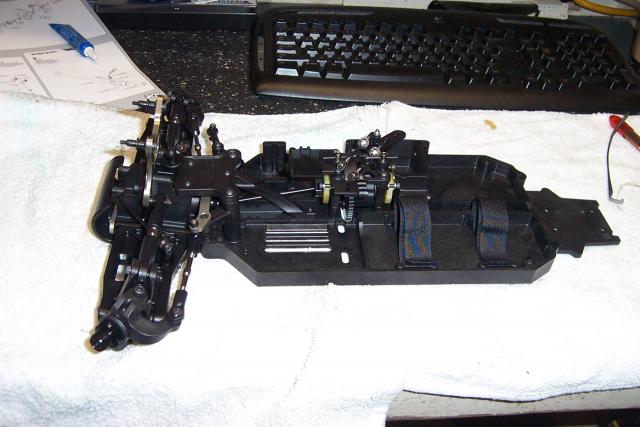

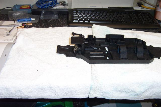

More pics - 12.30.2009, 12:25 AM
Here are some more pics . Thats it for tonight . I will post the rest tommorow .

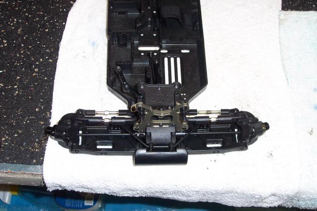

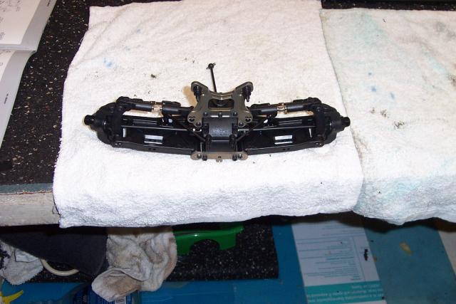

Here is some more pics for those that are interested .

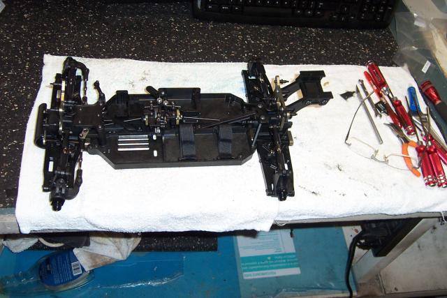

12.31.2009, 06:03 PM

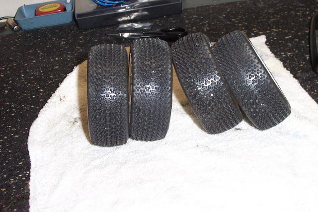

Thats exactly what those two holes on the RR knuckles are for . Here are the rest of the build pics for those that are interested . The tires are proline calibers, in m3 compound .

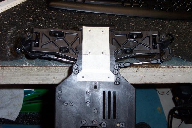

12.31.2009, 08:26 PM
Guys after reading about the ve8 chassis breaking up Fr & looking at mine that i just built . I think i may have come up with a idea to help strengthen the FR end . This is the idea i came up with . I was thinking 2mm or 3mm aluminum would work fine. Right know it's just masking tape to show what it would look like . It would double as a brace & skid pad . As you can see it would cover the seem were the FR plate & chassis are connected . The black line is there just to show were the slight bend would be . I would like to know what everyone's thoughts are on my idea ?.

  (#43)
Erevocanuck
12.31.2009, 09:06 PM
Hot bodies does sell front and rear skid plates.Maybe they could provide some strengthening

12.31.2009, 09:35 PM
I imagine those would make it stronger.
