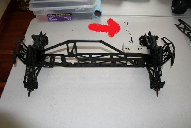

Just a pic showing the size of the 5T chassis... should get a pic of it with a battery and the XL chassis to really show the difference.

Whats this ??

<points to the Savage Flux 5T> topic title.... its the TCS Crawler 5T conversion chassis for the Savage Flux.

Sorry, I guess the picture I reposted with the crude arrow pointing at the home made battery/electronics gear "tray" wasn't enough ?
I'll try again with a Larger RED ARROW

That is just as you called it, a home made tray. This was actually a Savage XL that I had done a mid-tank mod to, so that's the tray for the Ofna 250cc fuel tank. Was probably just going to leave it rather than use the bulky plastic radio/battery/servo box of the Savage.

But, can't the front section be used for a battery tray easy enough ? Curious because this will be my next project .
The "roll bar" part of the TVPs looks rounded over on the edges ?

You mean where I have the "receiver tray"? I thought of that, but discarded it because the CoG would be very high for the batteries, and its not quite long enough either.
I was planning on creating a battery tray that would sit just behind the 'receiver' tray but down as low as I could go and still leave room for the drive shaft. Also looking at trimming off about 2cm of the receiver tray, which requires drilling new holes in the TVP, in order to move the batteries forward some more.
The "roll bar" part isn't no. I want to run a Baja 5T body (actually one of the Proline versions), the whole point of this project for me, so depending on how it sits I may at least lop at least the rear section or even the entire thing.
