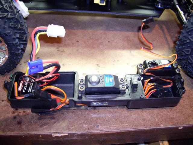

I just got my Ten-T in the mail yesterday. I am actually impressed with this rig. There is a ton of stuff jammed in a small package. For a nitro it's not a bad little package.
The tear down was very easy. The radio tray comes out with a few screws and everything except the temp sensor comes with. The engine and tank are also just a few screws. The center diff is the same. It took me an hour at most to get down to a stripped roller. That included opening up the center diff to find it packed with grease.
I'm out of brake cleaner so rebuilding the diff with 100k fluid is going to have to wait until tomorrow.

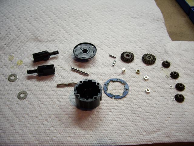

Pics of the diff.
