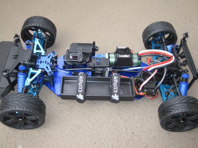

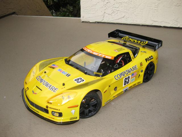

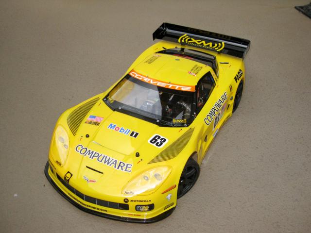

Okay guys I promised pics of the new beast so here it is!!
Parts used for conversion:
RCM Kyosho motor mount
Kyosho single speed center diff
Mamba monster ESC
Castle/Neu 1520 1y 1600kv motor
RCM 14t mod 1 pinion
Kyosho Inferno VE receiver box & servo tray
RCM Inferno GT2 battery box
Aluminum arms
Team Sweep black wheels
Ofna on-road tires
Kyosho front & rear torque rods
Scanner RC 9764MG high torque servo
Spektrum RS300 2.4 GHz receiver
Spektrum DX3s TX
So what do you guys think? Now let's see how fast this beast goes!!

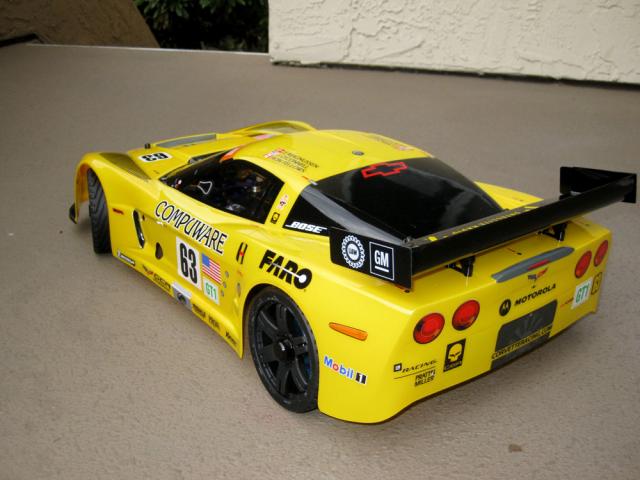

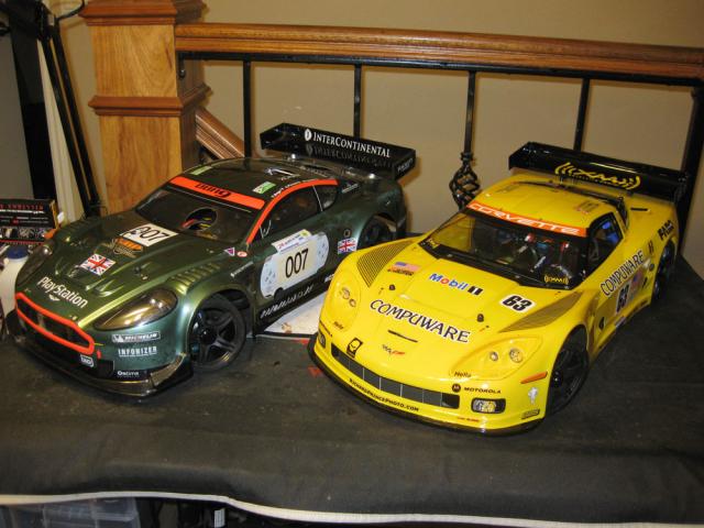

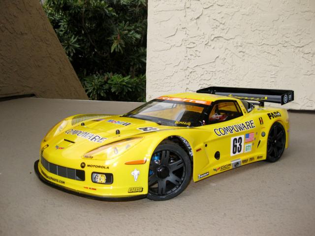

Here's some more.

Looking good mang. That Aston body is my favorite.

Thanks for the compliments guys. Yeah this car should be a blast. You can tell though that the IGT 2 is longer so with the Corvette body on it, it looks very scale. I used the single speed because it works really good on my original IGT & it goes ballistic on 6s. I do still use the 2 speed on my LST2 conversion & that thing as heavy as it is goes like a bat out of hell on 6s.
