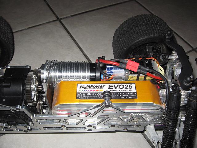

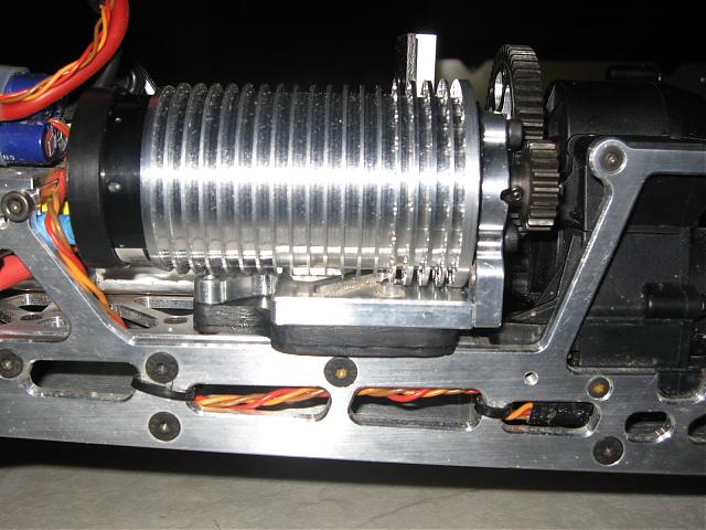

A few pic that show the new barrier I made using a stock chassis brace and some fiber board. Also check out the heat sink I got from tamjets.com.
A few videos to follow...

Nice heatsink. BUT wow $49 for it!?!?!
