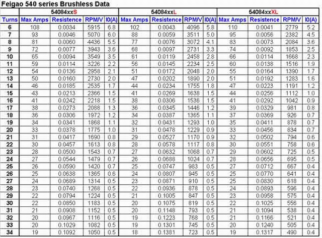

Damon aside from running a shade bit slower the 9turn will be a little easier on amp draw and have a bit more torque , here is a Feigao 540 motor chart that will help you folks out

KV wise, the 9xl is close to the stock titans. But it has a boatload more torque and will allow you to step up the gearing to compensate for the move in turn. And as said, the setup will run a bit better and be easier on parts
