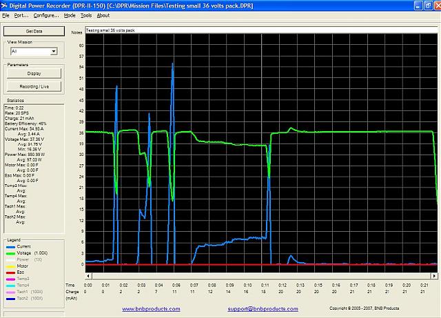

Nice little pack . I have attached the graph of some little bursts. This also shows the best regen braking action as well at around 12 seconds I hit the brakes.
Name:	Testing small 36 volts pack.jpg
