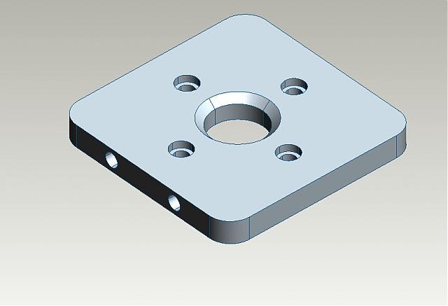

I have been wondering how you guys think i should mount the motor, right now my idea is to Machine a big hunk of .3'' thick delrin into a mount that would use the same holes as the center diff did.. Do you think it will be strong enuff?

Does anyone know if a Motor mount made of 1/2inch Thick Delrin will be enuff for the motor?

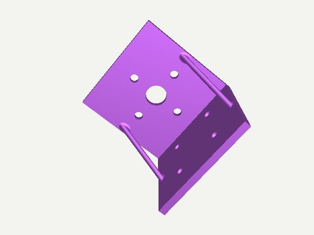

Hey Guys just a little update, my motor and Battery just came into stock and should be here shortly,It looks like the machined mount idea is a failure... might use some steel angle to make a mount, then either some round stock or flat plate for bracing... its really simple but should get the job done

Ehh a coupla reasons, i would like to make it myself for one, im not one to build things out of a box.... then b/c its not made for an outrunner motor, and because i need something that will keep the mount from flexing.
04.21.2008, 09:59 AM
Does the motor have screw holes at both ends? You could fab two of them together to make like a diff mount...

no, only at one end, the other side of the endbell spins with the shaft.
