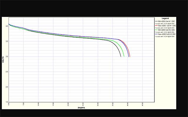

What cell do you want to see specifically? This is a new version of the 4000 cell vs the old version. The factory rates it at 4200mah. We rate it at 4000. This is the same cell that we use in our 8000 packs. At 20C, you can see that it holds what I would consider great voltage. I don't know how you could not call it a 20C constant cell based on the data...
-Austin

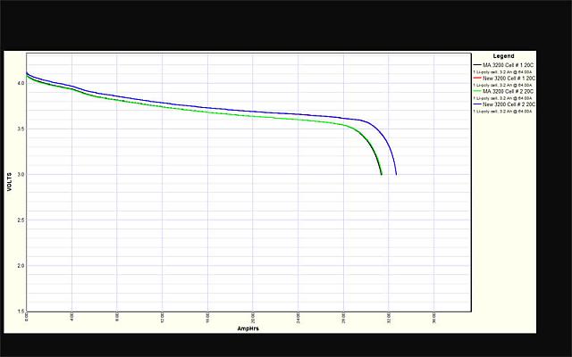

And here is the 3000 cells that we use for the 6000mah packs.
-Austin

I have a hard time releasing these because it gives our competitors an idea of exactly what they need to compete. As I have said many times, our pack quality and performance is second to none. The proofs in the graphs. I have not seen a 3000 cell or a 4000 cell on the market that will compete. If there was one, we would offer it.
-Austin

Awesome! Graphs! It might be my monitor, but could you blow them up a bit so I can read the numbers? Any temperature data and 1c, 10c, 15C graphs for comparison would be nice too. Especially temperature that is needed to duplicate these rates.
It is really nice to see some data finally, bravo Austin.
---JRH---

Looking at the graphs a bit harder here, it seems that the average voltage is around 3.6v/cell. Wouldn't this indicate that running them at 20C is not the max continuous rating, and that they could be pushed quite a bit harder? But at the bottom of the 3.2a/h cell graph it shows 12a/h on the discharge?
edit: my eyes hurt, I will wait for you to enlarge them before I try to read any more
---JRH---

I'm with you there JRH, I put it on photoshop 11 and blew it up, cleared it up as best I could, and still can't make out the numbers well enough.
